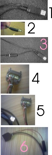

I think I have found my "ideal" travel charger....
I bought a $20.- USB hotsync cable and added a connector to it that allows me to plug in the Prism's original power supply (which even works from 110 to 240V AC). That way I can hotsync AND recharge while on the road. If there is enough interest, I'll be glad to popst detailed instructions. Let me know.

OK, I will post them soon. Note that it involves a soldering iron and -GASP- cutting the original charger's cable. I will take a few pics (lets see what this eyemodule is good for) and look for some webspace somewhere to post them to make it clear.
Basically, you open the connector that attaches to the Prism, solder two wires on pins 4 and 7 and then attach a DC connector to those wires. If you plug your DC charger into this connector, you will charge the Prism.

OK, here is the promised instructions on how to build your own PRISM travel charger. You need to buy Handspring's USB hotsync cable for this - $20.-. When you're finished, you can USB-hotsync AND charge with the setup (for about $25.-).
Refer to the attached photo:
1.This is the USB connector of the original Prism cradle. It has a little DC connector plugged into it that comes from the original DC power supply.
2. Shows this connector. I believe it is a 1.1/3.5 mm connector that is hard to get, so I choose this route. If you can get the matching jack for this connector, everything would be even easier. Note that + is the inner contact.
We now cut the DC cable (yuck!) to insert another connection - I choose 2.5/5.5 mm DC connectors but feel free to choose whatever you like or have. Solder the 2.5/5.5 DC plug to the side of the cable that comes from the power supply and the matching inline jack to the side of the cable that runs to the original 1.1mm connector. If you now plug them together it should look like this:
3. Measure the voltage on the little original connector and if it is still correct, you can now put the Prism back into its cradle and it will charge again! Nothing lost so far!
4. Now we take the USB hotsync cable and open the connector that attaches to the Prism. Locate pin 7 (not used) and pin 4 (used).
5. Solder a wire to pin 7 for + and one on 4 for -. Drill a little hole in the connector housing to run the wires out of and tie-strap them to the original cable.
6. Close the connector and solder another inline DC jack to your two wires (watch the polarity!!).
...see next post

We're basically done! You can now use your original power supply with the USB hotsync cable. You could easily add a battery pack or solar panel or nuclear power plant (nah maybe not that one) to your connection...
Post questions and/or experiences with the setup!

Ahh, one more thing: The DC connectors I got at Radio Shack:
1. DC Power Plug 2.5/5.5 mm, #274-1573A, $1.69 for 2
2. Inline DC Power Jack 2.5/5.5mm #274-1578, $1.79 each
