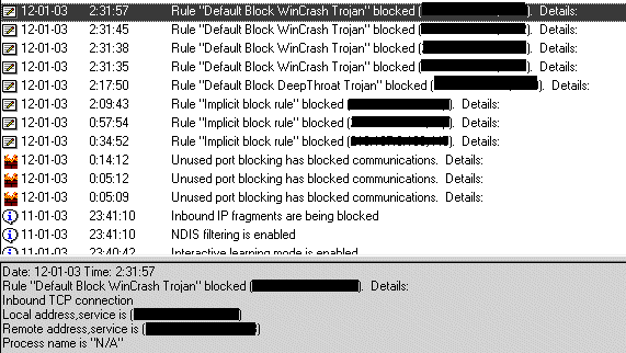

Hi
I hope somebody can help me with this. I've firewall installed on my PC, (Norton Personal Firewall) and usually when I leave the computer on through the night, in the morning I would get a Security Alert telling me that firewall had blocked a Trojan.
I've sent a screenshot of the firewall log.
I've scanned the computer with 2 of the most recently updated popular virus scanners already, but I'm still getting this about few times a week. I suspect some sort of calling card is on my computer, but like i said the Viruscans don't find anything.
What do you recommend I do to stop this? Or do I have to live with this?

Thanks BobbyMike, I really appreciate it, I'm using ADSL, and I don't think my IP is fixed. I'll check out cybertech.
I forgot to mention that I did a spyware search as well, nothing.
To be more detailed, occasionally I got an alert from firewall telling me a program is trying to access the internet. The list of such software include very random apps, among them:
rnapp.exe (dial up connection, but as I'm using DSL, this isn't even qualified!)
explorer.exe
netscape.exe (when I'm not using it, not even in the memory)
mplayer2.exe (media player)
nmain.exe (norton file. I won't allow it at all)
now, why would rnapp.exe or explorer.exe want to access the internet?? I'm doing fine with them NOT accessing the internet. And the scary part is, Netscape also wants a bit of action even if I don't have it open.
I may have to rebuild my system, but at the moment I just can't afford the downtime. I would have to rely on firewall at the moment.

What I've found is that often you will get port scans by someone looking for a trojan horse installed on your computer. For instance if you write a TH called "Fred" that listens to port 7, you will broadcast from your computer to port 7 at random IPs to see if Fred responds. Then you can do your dirty work. However, a firewall will block this and log it as a problem even though there is nothing malicious on your computer, and that even if the signal had gotten through, nothing would have happened because Fred isn't there. At least that's my interpretation.

I run Norton Personal Firewall as well. The report indicates that someone was probing one of your ports (whichever one that particular Trojan uses) to see if the Trojan was present. It does not mean that the Trojan is present, someone is simply looking to see if it is. If the Trojan were present and you were not running a Firewall, then they could do dastardly deeds to your computer. Basically, you are fine and need to do nothing else. If the probes continually come from the same IP address, Norton's does allow you to block that computer permanently. Looking in the instructions.
I agree that if you are not using the computer you shouldn't leave it connected to the net, even if you are paying a flat monthly fee and have a firewall. It is sort of like this. If you had a very rare sports car with an alarm system wouldn't it be safer to park it in the garage with the door closed at night than on the street? After all, someone still might steal the car or damage it despite the alarm.
And if you look at the log, it's blocked by default, that means that this is already a built-in security to prevent trojan horses, I have no idea what might be probing the port. The log also indicates a certain pattern... note that WinCrash was used multiple times as if repeatedly trying to crash me. It did got to me once, or maybe it was a coincidence, I came back to see a blue screen.
I was infected by T-Horses once back when i was still using dial-up but I'm not sure if the T-Horse is smart enough to know that I've completely changed ISPs considering that they (apperently) don't exist on my computer. So how can somebody just come up with a random IP address and get it correct multiple times??
Also, nobody I know of can explain the behaviour of all the other program files that i mention of. I'm guessing It's sort of like some super trojan horse is using these programs to disguise itself to access the internet. I can't block out some of the programs permenantly because that would stop them from working, (i.e, Netscape).

With regards to your original LOG... notice that what happened was packet was blocked on an incoming TCP connection, also notice that the attempt was blocked.
So 1 of 2 things here. Either some little script kiddie was scanning a block of computers for a vulnerability (which you DON'T have - obviously the firewall blocked the attempt). Or someone elses computer, unbeknownst to them, has been infected and is automatically looking for others to infect.
However, as people have already said - your firewall did what it was supposed to do.
If it makes you feel any better, my webserver usually gets maliciously constructed packets on the order of a few an hour... sometimes a few a minute. However, since I'm not running IIS (a microsoft webserver) they are all simply entries in a log capturing all errors. Basically the same thing as you've got.

Based on your attached log, the probe in question is inbound, and it is blocked - so what is the problem?
It appears that you are just being scanned for that particular trojan, which is not present on your system.
I leave my PC's up up most of the time, and I see hundreds, if not thousends of scans, it is just a fact of life on the Internet...
Keep you anti-virus def's up to date, and run tests on your firewall, and that is about all you can do.

The other 2 things that worry me is the fact that my programs at random behave strangely, wanting to access the internet at random times (read previous posts),
And Norton firewall has 2 weeks ago stopped asking me whether to allow cookies, even though I have set it this way deliberately (my security setting has been on the highest ever since). I just checked, it still is.
It used to be that I get lots of prompts asking me whether to allow a cookie or not. Now, even when entering an unknown site which I believe should have some cookies some way or another, it didn't bother to prompt me.
Either I have already block filtered all the bad cookies in the whole of Internet (impossible) or NPF (Norton Personal Firewall) just got lazy and fell asleep on its job.
Now it felt like a complete waste of money on NPF. Where do I get Zonealarm.
I'm sorry for sounding so paranoid but I'm somewhat new to firewall systems. Esp when things don't go as expected (didn't ask what to do with cookies when it should, and Solitaire trying to access the internet)

A bit of big picture advice: backup your data and don't worry too much. Take prudent measures (which you've done) but don't let it bug you.
