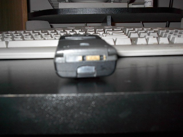

I'm looking for a cable to connect my Thinmodem and T19, does the cable you bought match the connector to this pic? If so where did you get it? I'd really like to connect using this phone (It's the one they handed me!) Thanks,
Sterling
Attachment: im000324.jpg
This has been downloaded 143 time(s).
I didn't think the Thinmodem can be connected to a cellphone...
