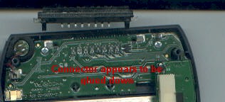

Looking at the connection - I don't see welds. It's like the connector was just glued to the board.
See attached for detail.
Has anyone else had this problem?
Attachment: broke detail.jpg
This has been downloaded 131 time(s).

Re: No jaws of life.
I seem to recall miradu had several with that exact problem.

This has been a fear of mine (got my stowaway a week ago). That connector is TIGHT. I've been debating finding a way to whittle it down a little - but I was thinking I might need that friction when using my xircom (heavy) modem...

I had this problem with my VP using the Flip-cover. Had to take it apart and reset the board into the locking pins. Ever since then it's been fine.

I had this problem. The connector is soldered onto the board and
not very sturdy. Handspring replaced my Prism.

I also had this same problem snapping my Prism onto the stowaway. Handspring replaced mine as well.

It never even occurred to me to call Handspring. I took it back to CompUSA and used up my extended warranty. They did not have any Prisms so I was forced to settle for the 615C. Now I have to decide if I want to get a cheap deluxe to use my modules in or just sell them off. The stowaway and the Voice recorder came from Office Depot just a few days ago so I can take those back.
I was going to stick with the Prism if they had one. I figured it was just a sign . . .
Glad to hear I'm not the only one to mess up my Prism.

Yeah I have kidna done that to my Prism twice..
It is a major design flaw IMHO. Notice how the Treo uses a complete different design for it's hotsync connector..
-miradu
